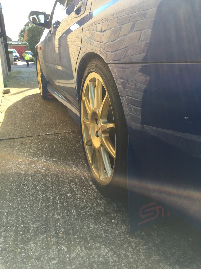

Any pics of the whole car as it sits lower now?
Rdlangy1 14-09-2015 11:47 AM
no whole car pics at the moment as it was p*ssing down - but once set up and the 18's back on tomorrow - ill post up some before and after pics :ok:

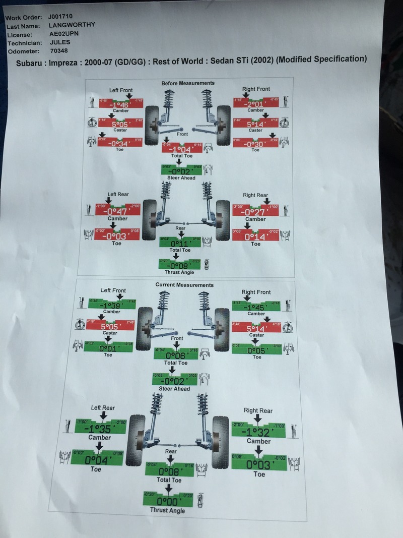

Rdlangy1 15-09-2015 11:08 PM
Well geometry was a bit out - to say the least!!!! (Top before - bottom after!)
http://www.southeastscoobies.co.uk/v...psichk2aho.jpg
Wheels back on and car looking a lot lower :ok:
http://www.southeastscoobies.co.uk/v...psjguqo8qh.jpg
http://www.southeastscoobies.co.uk/v...ps7ts7yxda.jpg
And neutral position switch went in also - wow what a difference! Got my top end power back and car feels amazing :ok:

Ginola 16-09-2015 05:20 PM
That looks much better on the Geo, If it was me Id want a little more toe in on the front but I'm really picky! :) the height looks much better too.. I bet she drives different now!
Rdlangy1 16-09-2015 05:49 PM
She feels very tight and secure on the road which is good :ok:
Rdlangy1 17-09-2015 09:43 AM
Originally Posted by Ginola (Post 214062)
....If it was me Id want a little more toe in on the front but I'm really picky! :)
Not picky mate - just you have a lot more ability than me ha ha ha - jules said I could have more toe in, but said it would be more possible to oversteer - and with my limited ability I didn't think that would be a good idea :ok:
(Yes he did chuckle and say - you only drive at 30mph - so what you worried about :ok:)

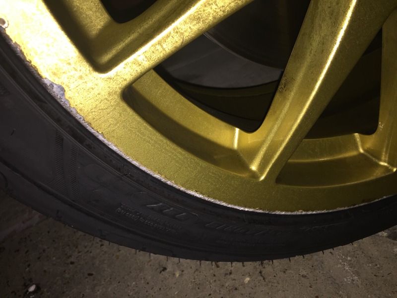

Rdlangy1 06-11-2015 02:13 PM
update- not the best one though! Took the car out last weekend for the first time in 6wks.
Drove 400mtrs down the road and was sat waiting to give way at parked car - got flashed through and as I started to go, the other car decided it didnt' wanna wait now, and so came through same time !
Evasive swerve = two ripped to shreds tyres (only done 200miles) + 1 totally fecked alloy (ripped the rim off all the way round).
Got two new tyres (£230 including new tracking set up) but need to get wheel sorted as its shocking... Looks really bad...
Lepsons want £105 to refurb the one rim...
joy of joys...
Rdlangy1 06-11-2015 02:27 PM
Oh and needless to say it went back in the garage (after a wipe down) and is feeling very sorry for itself ! ha ha ha
NL03Scooby 06-11-2015 07:25 PM
Such a dingleberry! I am sure you will get the wheel sorted soon, just how bad is it?
Rdlangy1 06-11-2015 07:40 PM
Pmsl - dingleberry! That a hayleigh phrase? :ok:
http://www.southeastscoobies.co.uk/v...psmud8xdz9.jpg
Looks better as new tyre covers the worst of it...
http://www.southeastscoobies.co.uk/v...psmohfpxgw.jpg
Doh :-(
Rdlangy1 06-11-2015 07:41 PM
It actually shredded the whole length of tyre protector off the tyres like spaghetti and they had trouble sealing the tyre coz the rim has lost its lip :-(
