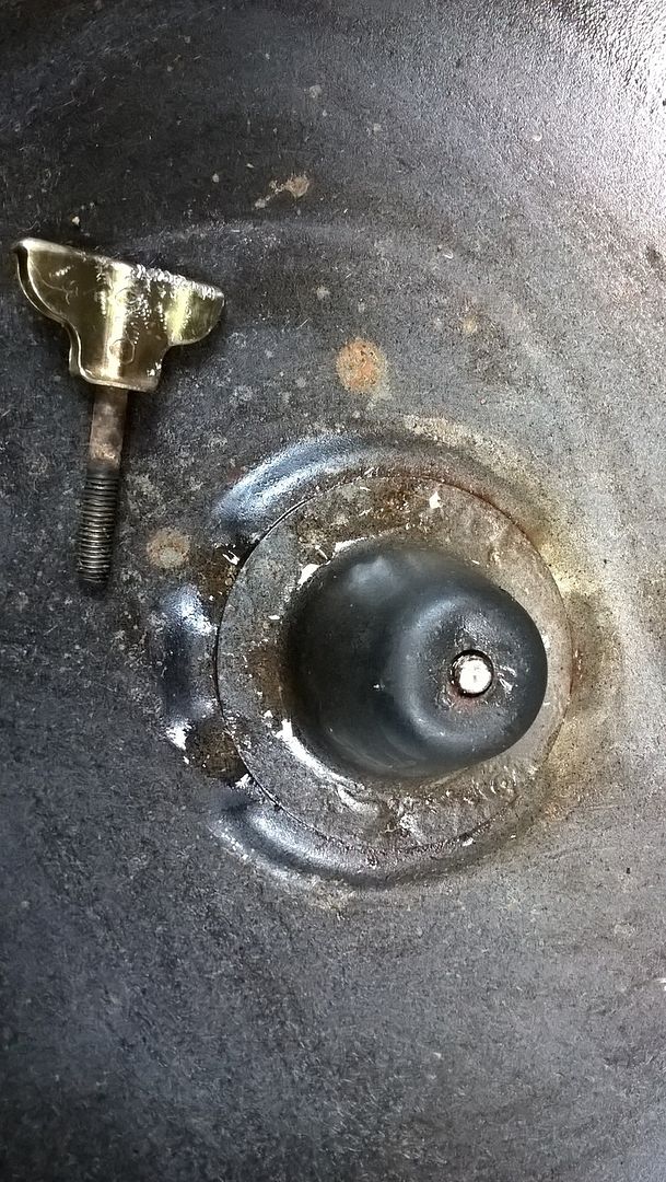

So today my job was finding the source of a little water leak in the boot. The spare wheel well had become a bit of a puddle and removing the coach bolt that held the wheel down turned into a bit of a fight.
So I went at it with a can of shock and unlock and some grips, then this happened....
So I'll have to be drilling that out now. Bugger.
But on the upside, I found the source of the leak and sorted that!

Talking of water features - when I released the spare wheel slightly, water literally p!ssed out of the draining hole. The wheel must have possibly been held down too tight and blocked it?
And yup, my leak turned out to be the classic rear light cluster leak - I'll be replacing the boot rubber liner too, for good measure.
