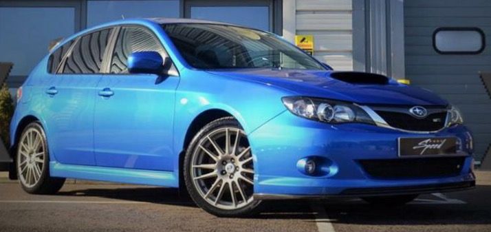

Evening all I've just picked up a 2009 wrx prodrive any hatchback owners on here at the moment it's pretty much standard I'm eventually looking to get it to 320ish bhp but I'm struggling to find any info of what mods I'd need ?
