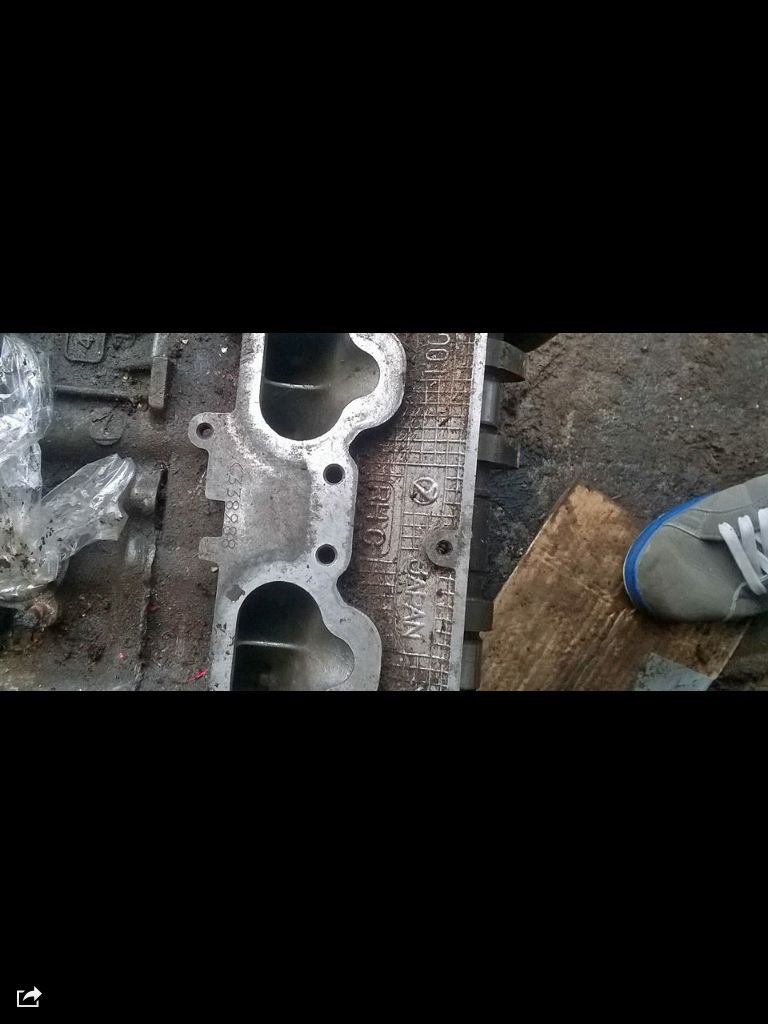

As some of you know I'm building my engine (slowly) lol I've been looking for some sti v5/6 heads, could someone identify these heads for me advertised as ver 5 sti heads.

v5/6 STi heads use 'under bucket' shims - its quite obvious from thse pics that they have the 'over bucket' std WRX/UK Turbo style............
so no

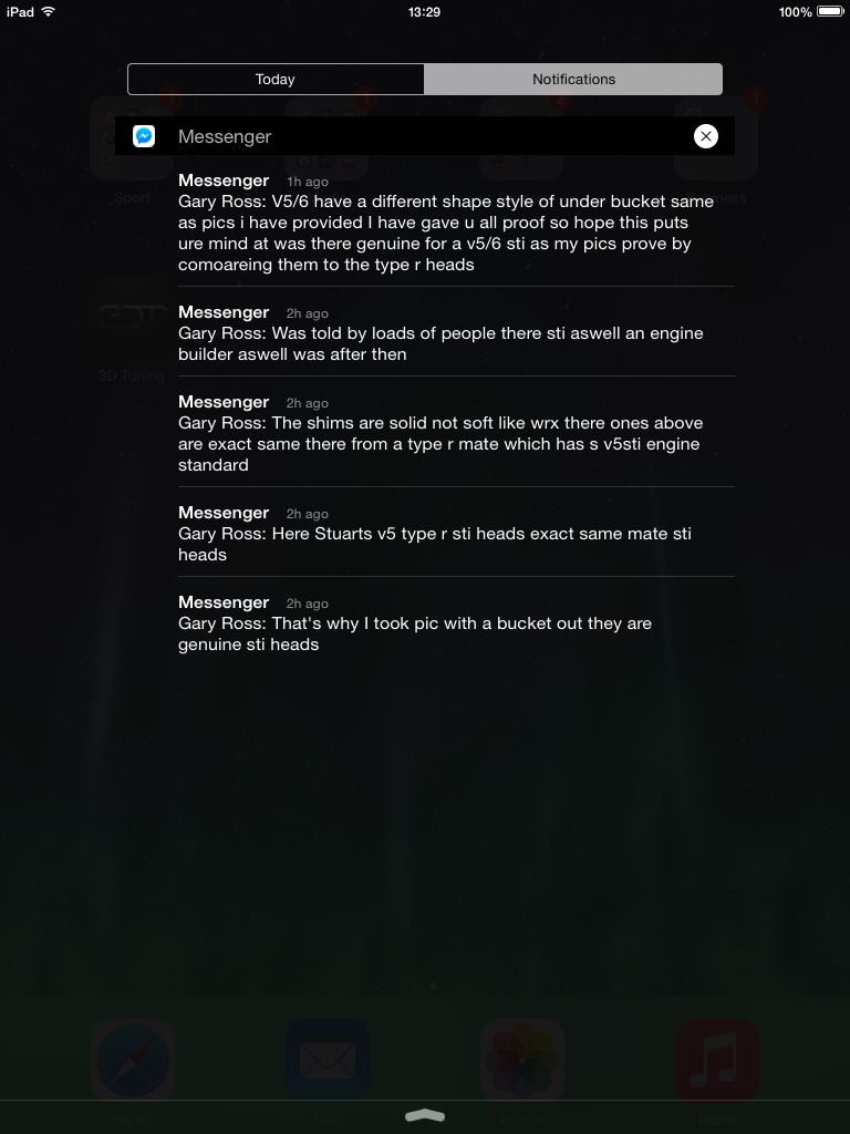

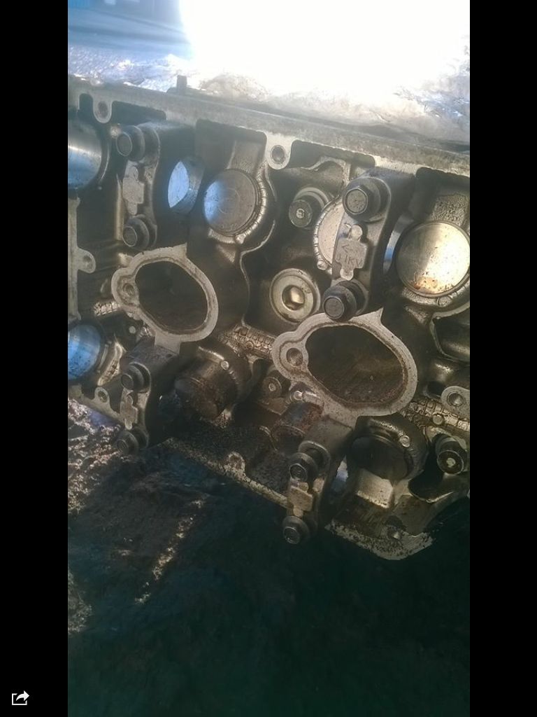

Cheers alyn, I've been in contact with the bloke and he sent me these replys

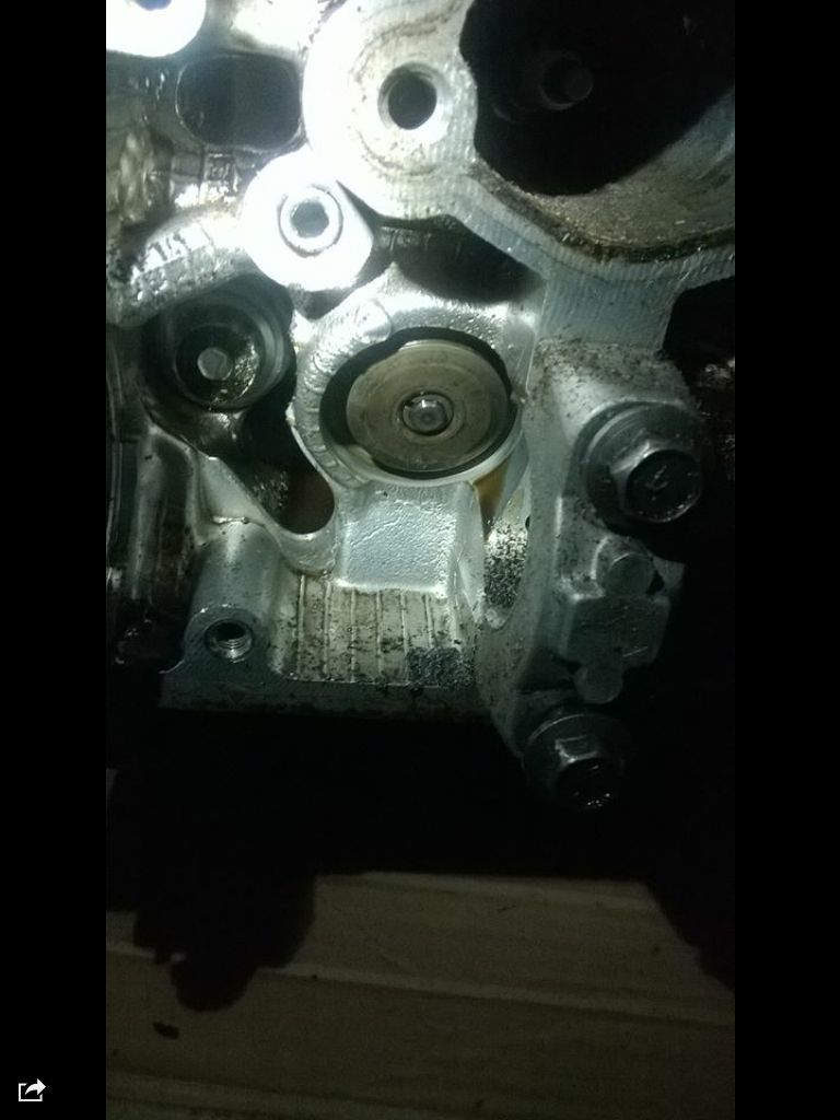

Another pic here I think confirming alynn explanation

they are std WRX/UK turbo heads from the same age car that use a solid shim ABOVE the bucket (you can see the small cutaway that allows the shim to be removed) - these are slightly larger than a std 10p piece
the pukka UNDER bucket shims sit direct onto the valve stem and are smaller than a 5p piece
