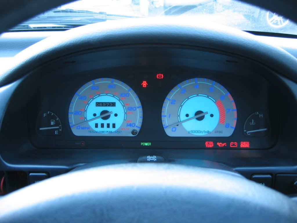

Very easy job
Drop the steering colum
Take the shroud off
take the inner shroud off - 2 screws
take dash unit out 3 screws i think - unplug connectors on back
pop clear plastic front off
unscrew back from black frontage
undo 2 screws on front of dial
slide new face on over the needle and under the black hub
- reverse above
30 mins tops.
Heres a set i fitted to a mates car that illuminate
