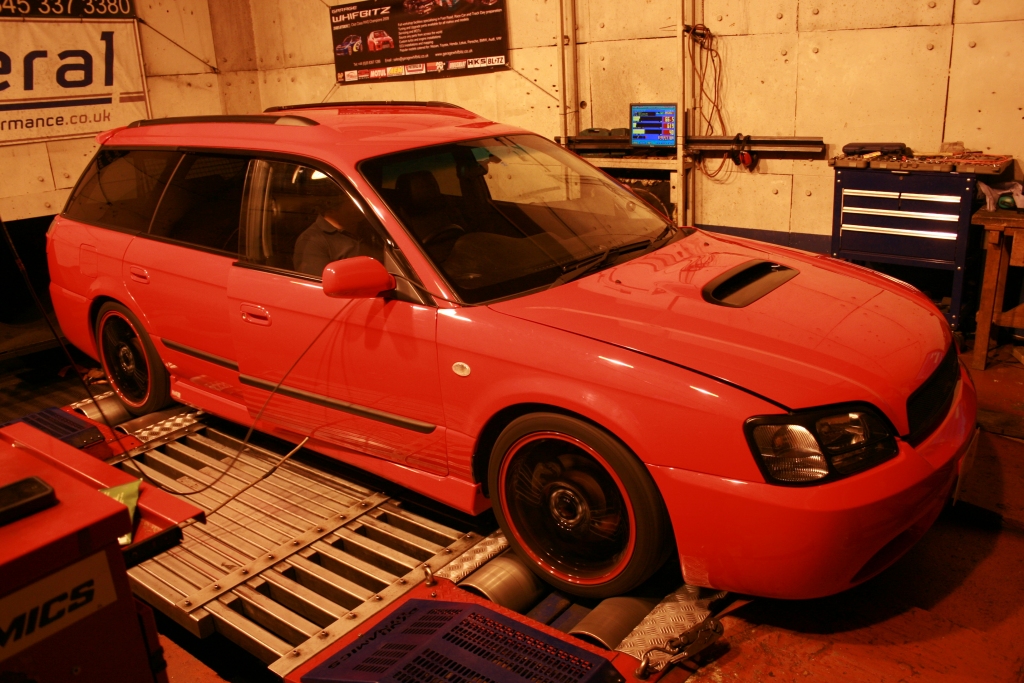

I was well impressed with my leggy wagon. 300.1hp, not bad for a fuel pump and a secondary decat. Was a good day out!
