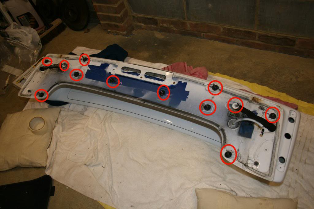

OK - before I HULK SMASH the poxy thing - does anyone know what the hell I could be missing when removing my STi spoiler from my 2002 bugeye?
Ive removed the brake light connector, removed the 10 bolts - and lift - well it lifts in middle, and lifts at back, but either side wont budge...
Def can't see anymore bolts to undo unless your meant to remove the tension bars? Can't believe the tension bars are attached to the spoiler?
anyone let me know what the hell I could be missing?
I can lift it up about 2mm, and I can see some sort of white plastic clip - but can't see anyway of removing it. tried everything - anyone any ideas?
HELP !!

There are 12 bolts i think.... not 10. Hang on a sec, i'm sure i've got a photo of the one on my car when i was sorting it.....
Old 22-04-2014, 06:58 PM
Posts: 13,288
Here.... let me know if you want hi-res photos of each side as have them too.

You sure it's not 10 bolts and 2 poppers Steve
I'll check the hi-res photos later but i've got a feeling it might be 12 bolts + 2 poppers? Would check now but i'm on the laptop sitting on the sofa in front of the champions league footy

HI Guys,
Thanks for the replies - it was 12 bolts - there are two hidden under the rubber boot stops - bl**dy Japanese hiding things ! ha ha
broke the two white clips - but its off.
Only downside was the foster lad dropped it when lifting it off, and chipped the boot lid !!!! GRRRRRRRRRRRRRRRRRRRRR
