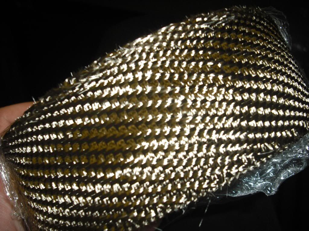

there is no point going for cheapy wrap as it will break up and go tatty and need renewing after a short space of time. buy cheap by twice!
If your going to do it, do it properly with DEI titanium wrap. This is what i have, and we had to cut it using tin snips. And it looks cool
Old 16-02-2010, 03:44 PM
Thats the very stuff I bought. Top gear
