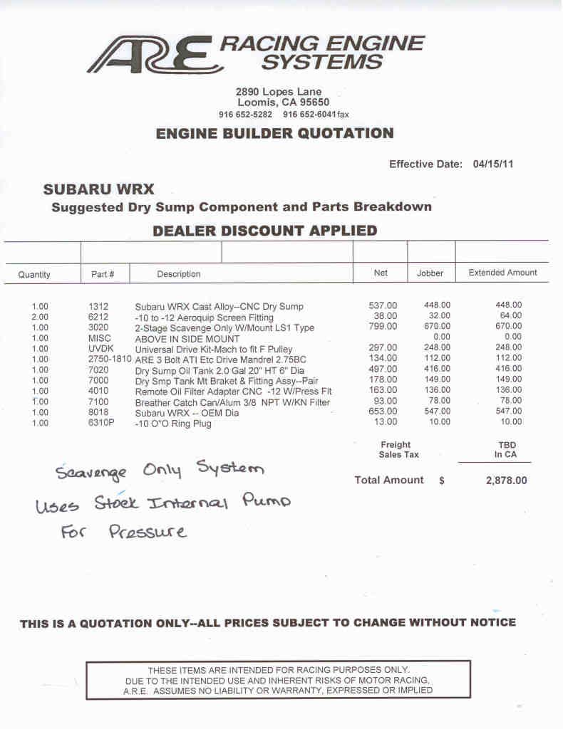

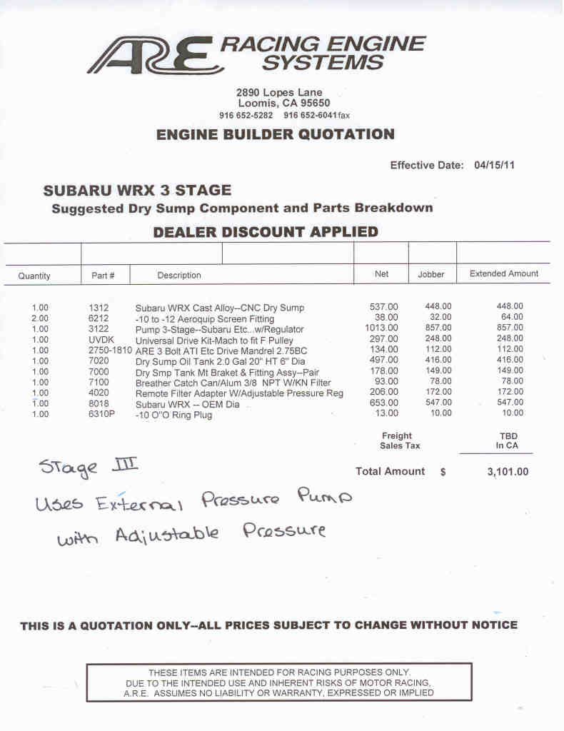

Here is price list for ARE Dry sump
http://www.drysump.com/index1.
Jura
Old 18-09-2012, 11:02 PM
Thanks for the info Jura, I'd seen the ARE kit on drysump.com but had no idea what parts were needed! Seems there's a few options, have to start saving!!
