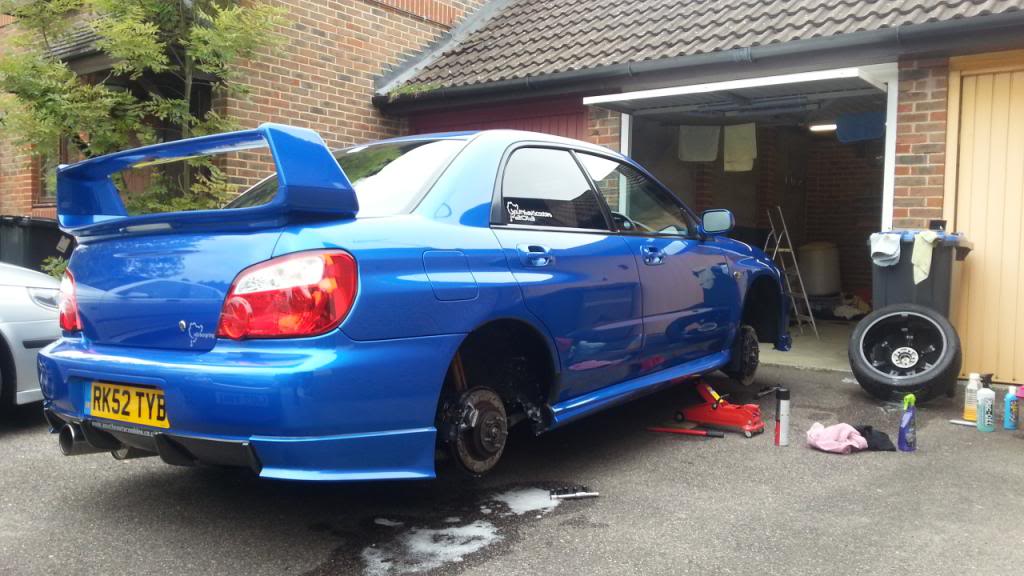

Spent today giving the car a good clean ready for Supercar Siege (well, until it started to rain....) as it'd not been washed for over a month. Brakes and front wheels were pretty filthy from use at Goodwood
Used it as a chance to take all the wheels off and give the arches a good scrub off too. Looking much cleaner now
Hopefully it'll stay dry this weekend as i doubt i'll have time to wash it again before Germany on the friday.

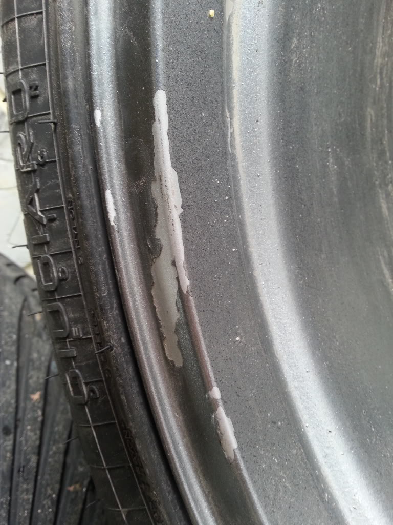

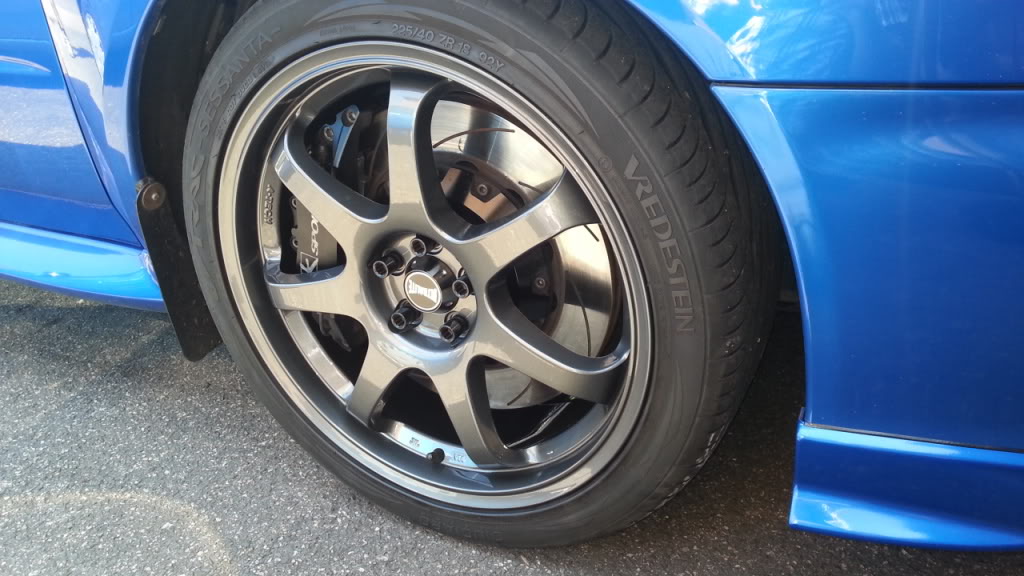

Old 08-07-2013, 11:28 PM

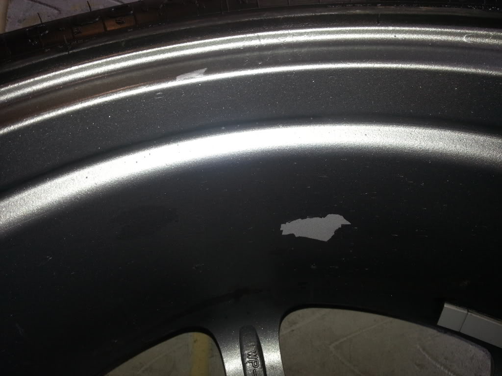

I noticed when i last had the wheels off the car for a big clean (before Supercar Siege) that the paint on the wheels wasn't in good shape. Lots of flaking and the rain at Goodwood had got underneath and made it worse. All of the wheels had bits like this
They got a very quick coat of gunmetal from a rattle can over the top, then a heavy coat of lacquer to form a temporary seal and that had to do for Supercar Siege and Germany.
So last week finally got the refurb sorted. Thanks to CJ for the free lend of a set of 18"s and got mine refurbed by WheelWorksUK in Crawley. Really pleased with the finish
Nice and spotless. Will be staying away from kerbs!

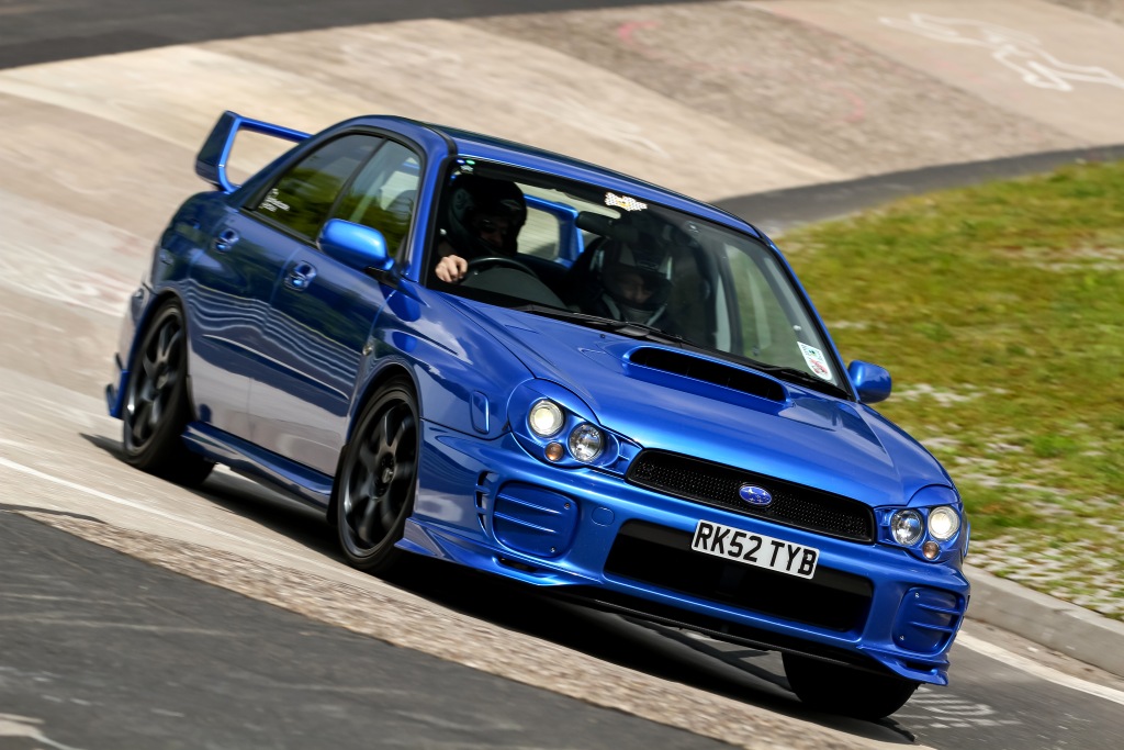

And a couple of photos of the car in Germany this year
Out in the rain on the Sunday in the mini karussell
And on Saturday in the big karussell!

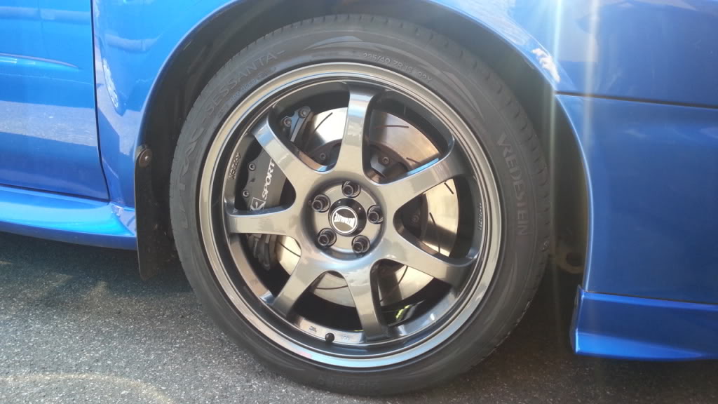

Old 28-09-2013, 06:54 PM
Nothings really changed on the car since Germany, other than I now require some new front droplinks as Germany and Brands more recently has killed them and the bushes are all split. Easy fix though
Over the last month (when i get a free hour or so) i've been working my way round the car panel by panel - wash, clay, and re-wax. Finished the wheels off last weekend and a few last minute bits today so its ready for Modified Live tomorrow. Arches all cleaned, interior hoovered, wheels were even removed, clayed and sealed.
Shiny
It better stay dry on the drive to Brands tomorrow morning!

Old 29-09-2013, 11:45 PM
Really do like the shiny on the inside paint job you have had done to the rims Steve,
Thinking about getting the same done.

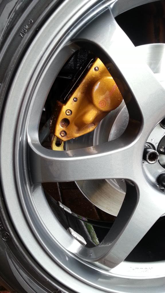

Been quite a while since this was updated, but the car is now ready for Germany again
New droplinks fitted last month and geo re-done as it was surprisingly far out, just from pot-holes in our crappy roads i guess. Track day at Goodwood in April identified that one of the rear calipers had a sticky piston, plus the discs/pads were pretty old so time for a rear brake refresh.
Rear brembos sourced from JPP, plus pagid discs and PFC-08 pads from Alyn. All fitted today at SMD

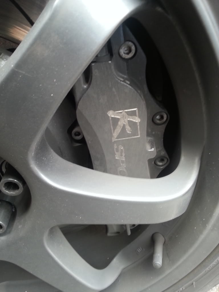

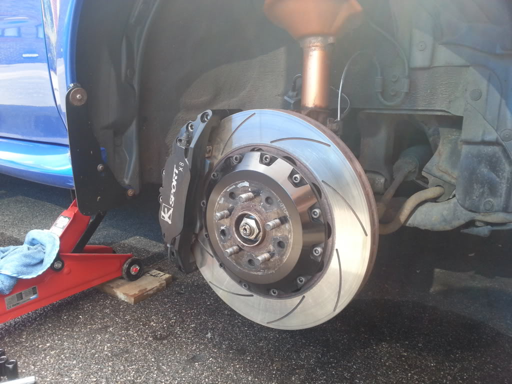

Old 15-05-2014, 05:33 PM
Steve just notice you a running ksport on the front are they 330mm discs as the look massive .
  #190
Old 15-05-2014, 06:25 PM
356mm 8 pot kit

  #193
Old 15-05-2014, 10:08 PM
Oversized shoes from Alyn. Handbrake seems fine at the moment, so we'll see how we get on with it....
Only issue we had was that I picked the cleanest set of brembos off the shelf at JPP and they must have been off a hawkeye that originally had the extra plate with the rubber things on it - noise/rattle absorbtion?
If you try to fit them without this, the original caliper bolts just touch on the rear of the disc Easily fixed with an extra washer though
