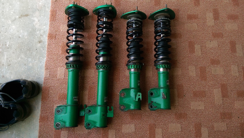

Time flies by... nearly a year since I updated this thread already. Priorities have changed, renovating a house and having a little'un means the scoob has spent a lot of time tucked up in the garage doing not a lot.
Still, some changes since last year
SMD fitted a Lateral baffled sump last Autumn, and began the job of getting the gearbox refurbed. Unfortunately, it turned into quite a saga and eventually we ended up identifying that a faulty Exedy clutch was the problem. Some of you know the details, but its a long story that would take far too long to type here (plus i've tried to forgot most of it deliberately!) It took many weeks to resolve with gearbox swaps and flywheel changes etc. SMD were top drawer thoughout though, especially as all problems ended up being cause by a faulty part that i'd supplied myself.

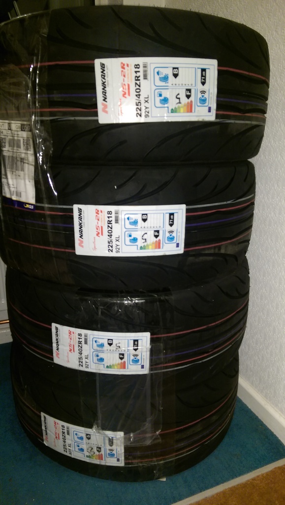

Anyway, since then..... bought a set of freshly refurbed PFF7s from Joel and fitted my current Vredesteins to them... new road/winter wheels.
These turned up for the Ultralites... Nangkang NS-2Rs in 120 soft compound.
The current suspension has also been replaced with a set of Tein SuperStreet coilovers. Its really sharpened up the handling and there's much less roll/pitch compared to the Prodrive springs I was running before.

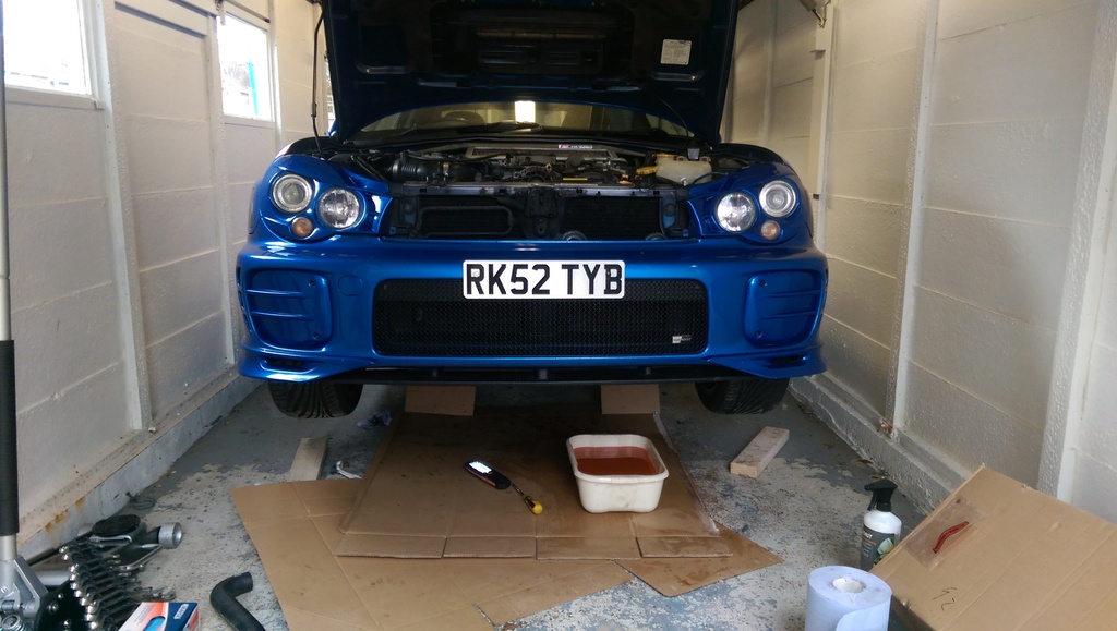

Old 09-04-2016, 10:34 PM
So... little update..... After failing a couple of weekend ago to get the car up in the air high enough to get my axle stands under it with my existing jack (no room in garage to jack from side) i invested in one of these:
http://www.sgs-engineering.com/garag...m-trolley-jack
Nice bit of kit and a good reach.
So spent this afternoon under the car tinkering. Definitely won't be in the scoob at tomorrow's meet as it currently has no coolant (or battery) in it.
Changed both the top and bottom rad hose easily enough, although one of the oem hose clips was being a bit of a pig for a while.
Still have the minor oil leak that I discovered last July (been busy working on house rather than car!) so next job is to fix that. Definitely looks like its seeping out between the block and the oil modine as the block looks clean and dry but the sides of the modine are all oily.
Got a replacement O ring for it, and having no coolant in the car will make the change easier too.
Couple of questions though.... first - coolant recommendations? Not sure what was in there before as I expect SMD put it in there but it was a nice shade of orangy-pink.
Second... the expansion bottle is a right state, full of slime and gunk at the bottom. I could probably clean it out with a pressure washer but it'd be a damn messy job. Was thinking of just replacing from importcarparts for a shiny new one, but the one they list is 02-07 and different part code to whats stamped on my bottle.
http://www.importcarparts.co.uk/part...y=&searchPart=
I know the radiators are different between bug and blob (blob has filler cap on top) but anyone know if the expansion bottle in the link would fit a bug? Surely they can't be different
  #238
Old 09-04-2016, 10:43 PM
I ha e the motul expert coolant in mine - recommended by Alyn - good stuff
And obviously coz it says expert in the title it gives me 5bhp extra Pmsl
I won't be in the scoob tomorrow either - so u won't be alone in the daily drive
  #239
Old 09-04-2016, 10:48 PM
Opposed Forces suggests it could be the same... look at item 7. If you click through to the part numbers and look at the "usage", the dates suggest a wide coverage.
http://opposedforces.com/parts/impre...llustration_4/
Hope that helps!
  #240
Old 10-04-2016, 12:20 AM
Just put the same coloured glycol based coolant in that came out, doesn't need anything special, as above bottle didn't change till 05 when they went plastic (which are easily broken!)
  #241
Old 10-04-2016, 08:04 AM
I've got a blob radiator in mine and a bugeye bottle if that helps? I cleaned mine out with a bottle brush and pressure wash last time I dropped the coolant - not as new but good enough for me.
While you're working in that area take a good look at the hard cross over pipe from the modine under the engine as this rots badly. Also the water pump pipes (small L shaped pipes behind the timing covers).
£36 not much to pay for peace of mind.
Or £46 for the bling version!

Old 13-04-2016, 09:44 PM

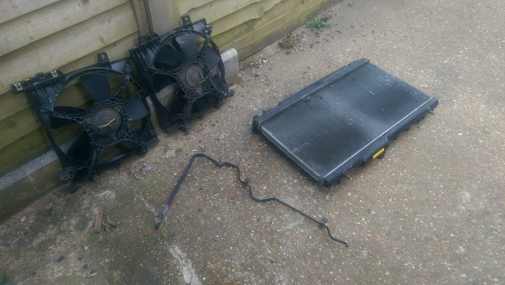

Nick, thanks for the heads up about the modine hard pipe. I've had a look at mine today and it is corroded but it appears to be just surface rust. However, I think it's best to change it considering i'll probably never have as much access to it as I do now. Only thing i'm not sure about is how the support bracket is fixed to the block, looks a bit odd.
And do I have to remove the timing belt covers to change the other water hoses in that kit?
  #244
Old 13-04-2016, 09:54 PM

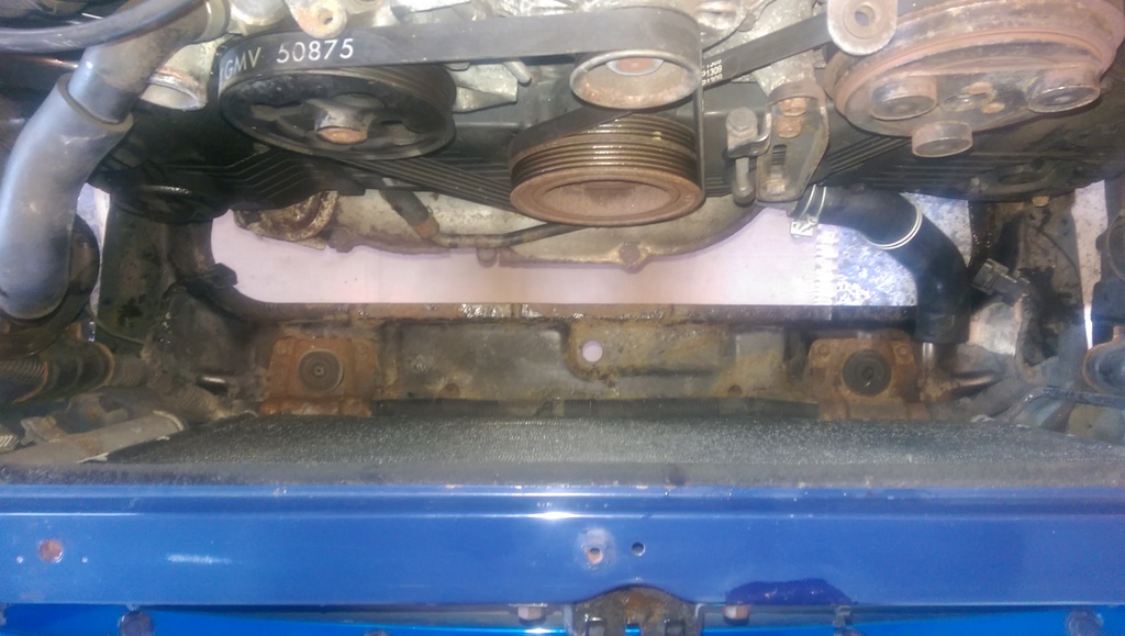

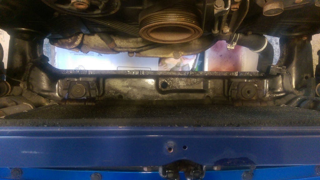

Loving the lighter evenings too, got home from work and managed to get a couple of hours in the garage tonight. Still not fixed oil leak (yet) but took a look at the radiator closer. Back of it looked absolutely fine and front is not visible due to air con rad but once removed i was pretty surprised, all the fins are turning to dust:
I can literally run my finger down the radiator and the fins flake off. Time for a new one of those then! Still, its the original so 14 years of life isn't too bad.
Found rust underneath though Before:
And after a clean up, wire brushing with a rotary attachment on my drill and some rust treatment:
Will get a nice coat of black stonechip tomorrow after work

Old 14-04-2016, 07:01 AM
You can do the hoses without removing the timing belt covers but you need a long set of angled needle nose pliers
Support bracket should be a single bolt
  #246
Old 14-04-2016, 08:34 AM
Just to remove the clips i guess? Will look into it... have you done it yourself on your scoob whilst engine was in situe or when it was out of the car?

OK. Don't really want to take the timing belt covers off. The sides look simple but the access means the centre one probably needs to come off to and that gets me into removing the bottom pulley and belts which I don't want to do (mainly as i don't know how and don't have a puller )
The kit comes with clips so i guess i could dremel the old ones off easily enough if the orientation of them is all wrong!
  #249
Old 14-04-2016, 12:08 PM
I'd try to see if you can remove the clips leaving the pipes in place - slide the clips off the hard pipe underneath before cutting anything as if you can't you can just slide the clips back into place.
  #250
Old 14-04-2016, 12:13 PM
Well... new radiator, coolant and modine hard pipe ordered from Alyn @ AS Performance, great service and advice again as usual
