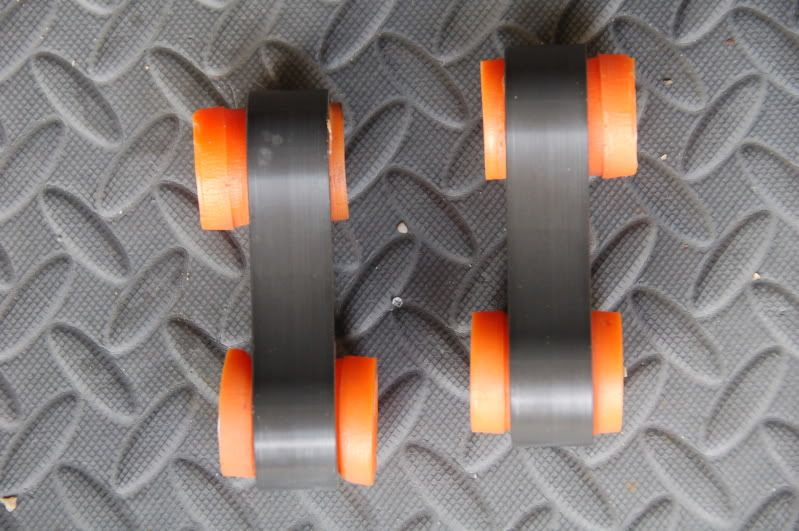

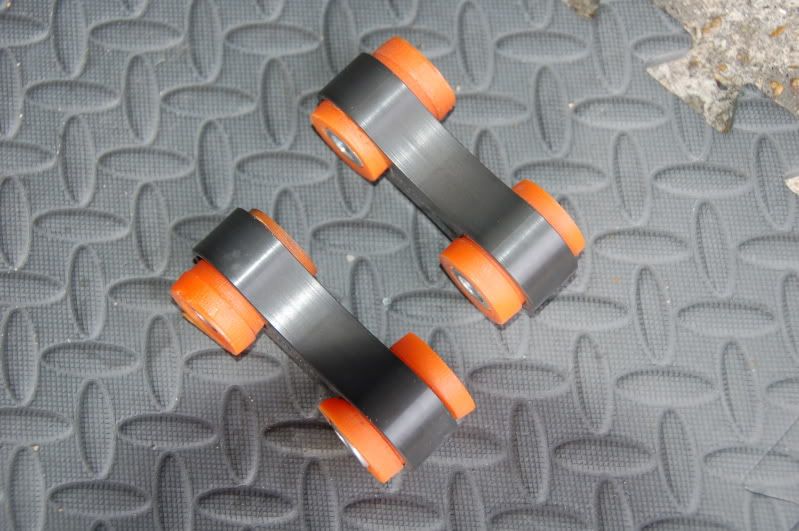

Gimpy had a knocking noise on the front, so he decided to change to Whiteline droplinks and this is what we found on inspection of the CDF items
The bushes had totally warn in no time at all and have marked the ARB

As in other areas of life, its the quality of bush that matters.
There is cheap soft bush that wears and becomes slack and then theres a harder bush that stays tighter for longer. The machining by cdf looks fine they just need to invest in better quality bush .

Last week driving in the dark coming home from work doing doing 70mph round a bend on a carridgeway the car made a "clonk" noise and moved towards the left. Felt like the tyre had gone .
Looked under the car and found the drop link at a rather odd angle and resting direct on the ARB.
The damage is marking the ARB and the arms slightly.
The drop links machined are great but as has been said the bushes are very soft. Also the spacer and large spacers are very soft material. One of the large spacers were almost bent in half.
As for Jimmy fitting. It was my request to get him to fit them on my behalf. So no fault towards Jimmy.
