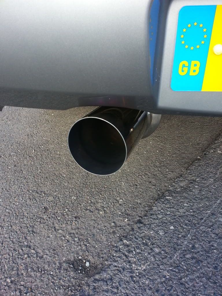

Exhaust update. I was offered a vortex afterburner back box and the car sounds great. Not as loud as I was expecting, but my hawk now sounds like it should. Will prob stick with a resonated center section now.
Thanks for your help
Excellent. Nice exhaust the vortex. I still give it a few weeks before you get tempted to do the res section tho

It has a nice sound. Not sure about the 4.5 inch tube though. Fancy something that has a similar sound but a bit more like stock in terms of looks. If it exists.
