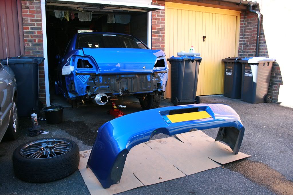

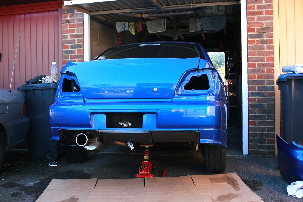

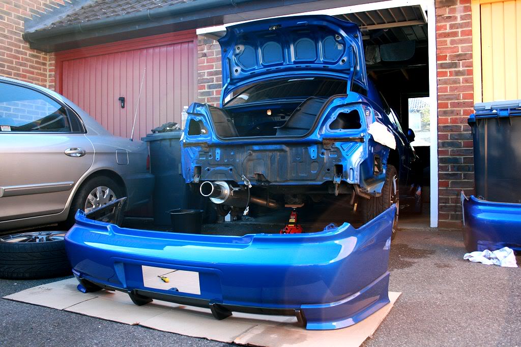

Thanks for the offer Tim, but the weather was so nice today i decided to have a go on my own. Didn't prove too difficult, even for a numpty like me
Masked up the rear quarters above the bumper ends just in case i slipped, trying to line up both sides when you're only holding the middle is a challenge!
Will get some pics in a bit
  #52
Old 19-03-2011, 06:48 PM

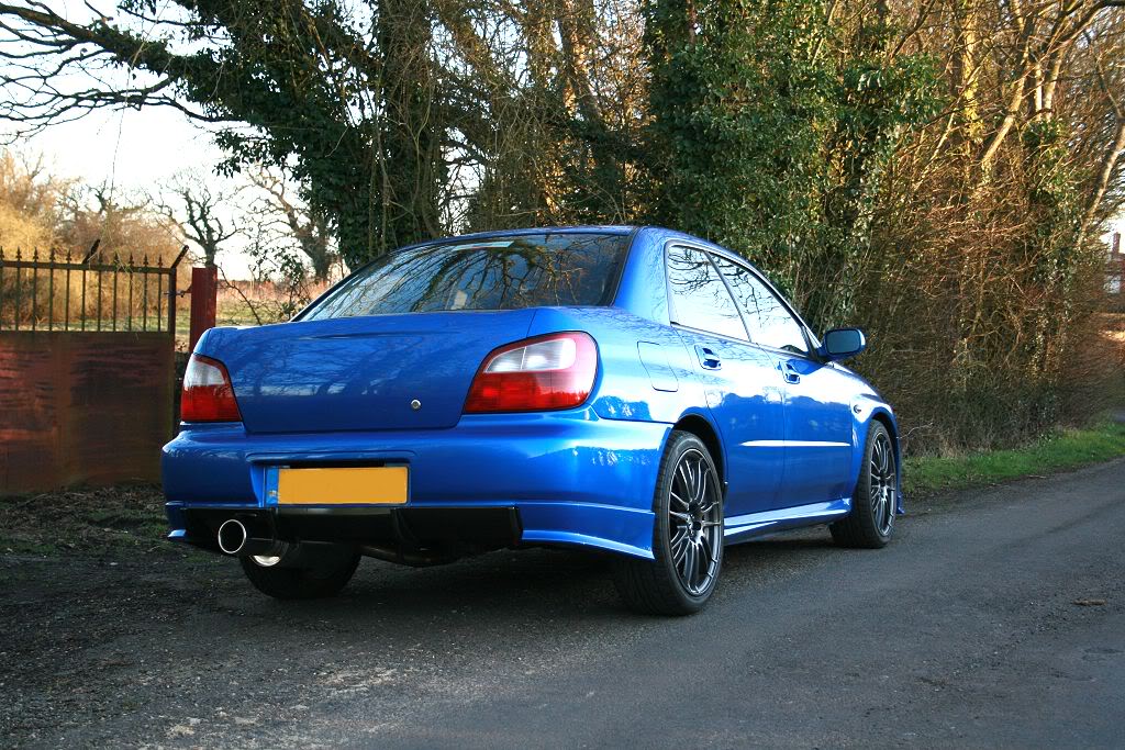

During the swap....

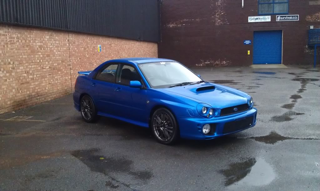

And how it looks now. Removed the flaps too, haven't been flapless for about 3 years!
  #53
Old 19-03-2011, 07:07 PM
Looking good Steve, but needs dropping to carry off the spoilerless look for me IMO
  #54
Old 19-03-2011, 07:09 PM
good going
not my cup of tea ,each to there own
  #55
Old 19-03-2011, 07:30 PM
Looks a good days work steve, excellent

Looking good,just above as James/Anger said need drop/lower

nice +1 for lowering

Car looks a bit higher than normal in those pics but i think its cos it wasn't on the flat - half on, half off the road.

Hi Steve i've before fitted 40mm lowering springs,recommended.

Are the rear clusters like the Classic i.e use loads of black gunge to seal them ?
If so I hope u used some when re-fitted

The cars on Prodrive springs now (same 30mm drop as Eibachs).

No black gunge at all, just a foam type seal thats compressed between the bodywork and light unit.

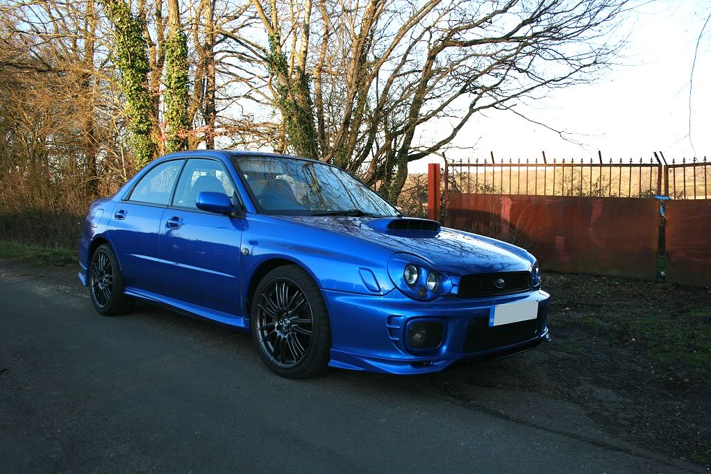

Time for a bit of an update i think.
Did an evening session at Brands which went well, apart from melting a set of brand new Bluestuff NDX's (yes, the copper in them melts at 1100c, so a bit toasty).
Top marks to EBC who got involved with a thread on scoobynet, and they've sent me a replacement set of NDX's to try, as well as a set of yellows (for free). Seems there are issues with the pad on WRX 4 pots and EBC wanted people to try options and give feedback. Anyway, brake fluid change this morning was the final step before being ready for the Ring this weekend (cheers to Brent @ SMD for fitting me in, rather last minute!).
Some photos from Brands:

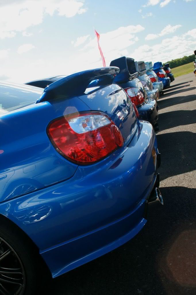

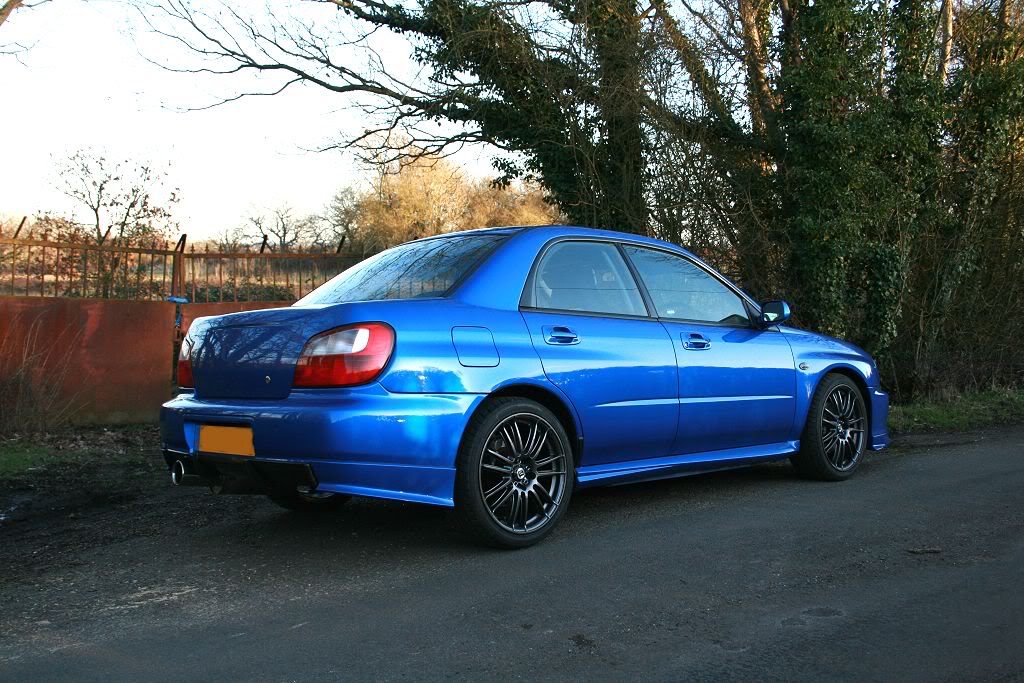

Other recent changes - i've sold the despoilered bootlid and currently gone back to the WRX one. Hopefully this won't be staying too long as I have a little project to work on.
Also picked up a set of blobeye lights
Really like how they look, make the back of the car look much newer, especially with the new bumper/diffuser.

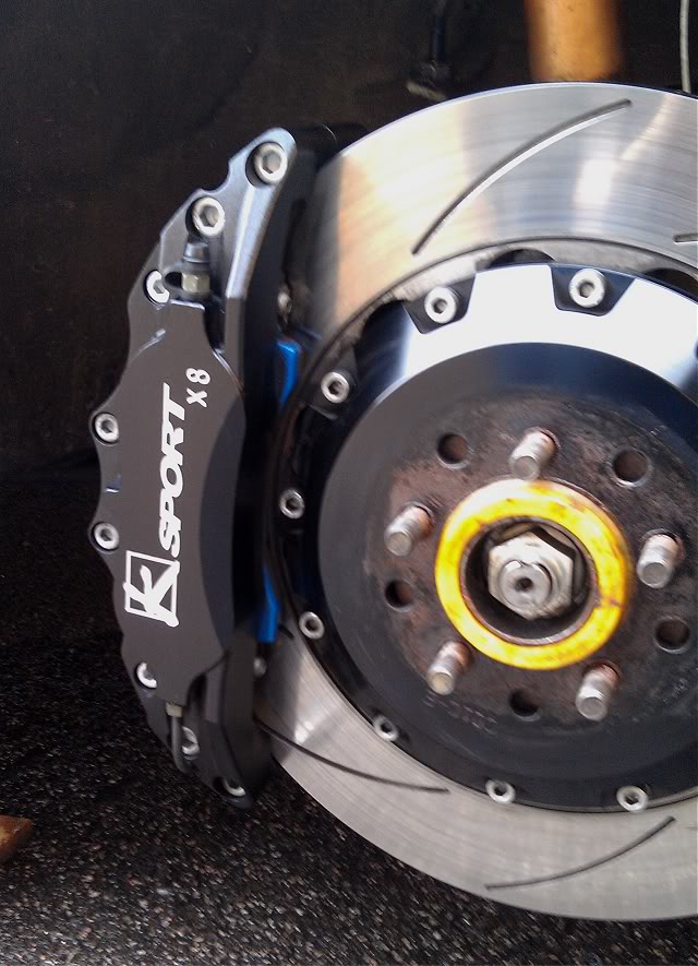

Old 18-06-2012, 08:38 PM
After that, i saved up the pennies for a while and decided to address my problems with melting front brakes. So at Christmas, these arrived 356mm 8 pot Ksport kit from the group buy on Scoobynet, with bluestuff NDX pads.
They've totally transformed the car on track, and got some serious abuse at the Ring and even more so at Goodwood. They don't fade at all and the stopping power is just nuts. Might have to address the imbalance from front/rear as the below pic shows

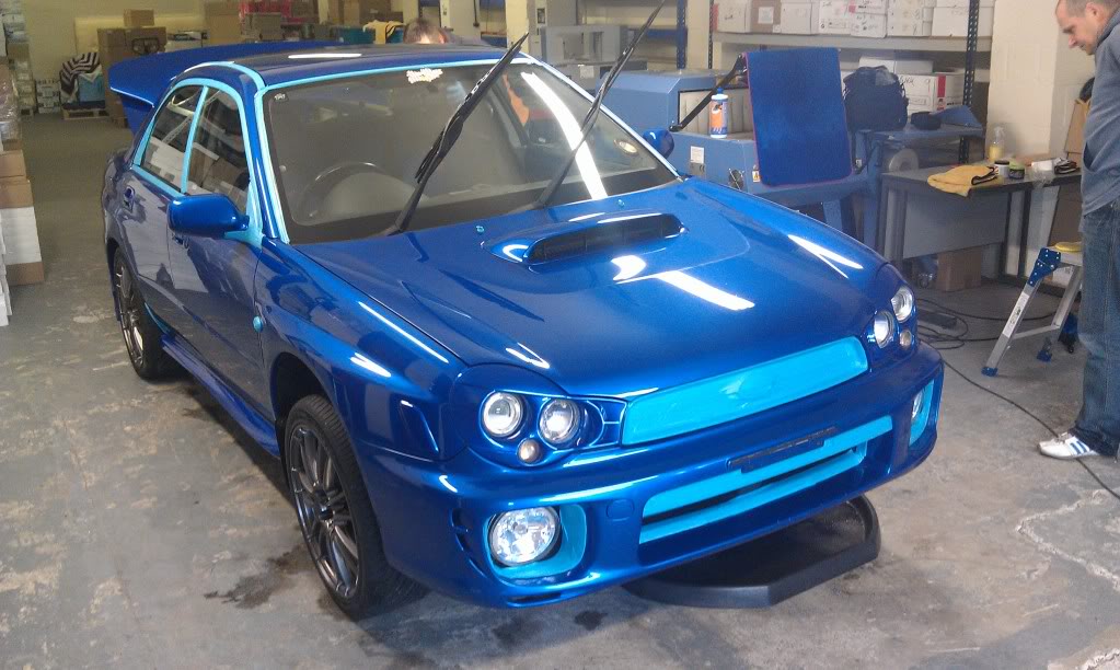

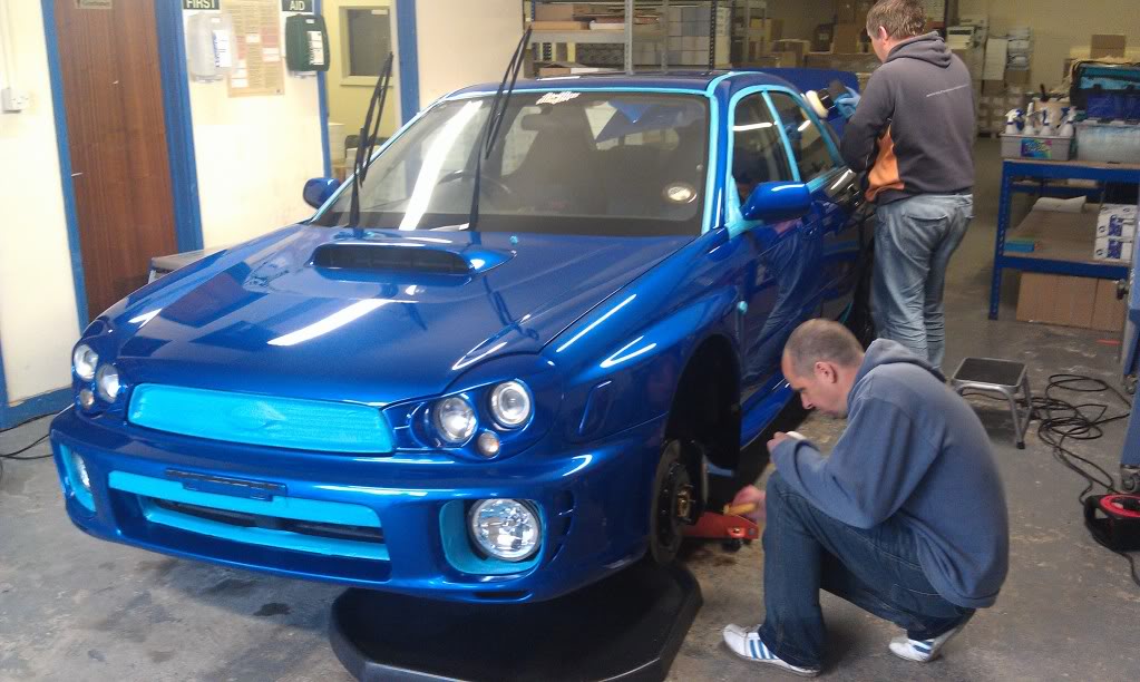

Last update.... bought a genuine STI spoiler to replace the crappy replica. Only problem was it was white (off Anger's trooper) so huge thanks to Tangowayne for painting the spoiler and bootlid, plus the new splitter and fog covers at the same time.

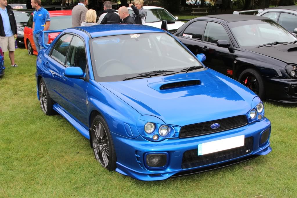

Fog lamps removed before new covers fitted, and all now done bodywork-wise. How the scoob looked at the Ring:
And at Goodwood:

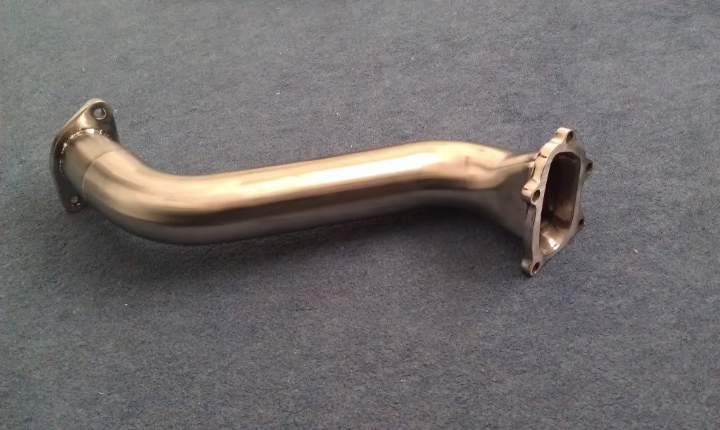

Old 12-09-2012, 12:09 PM
Had the car for 5 years now, and finally going to get round to decat/map. Its been running rich for a while anyway so i need to get the fuelling checked anyway.
This arrived today from the H&S group buy, shiny
It also weighs quite a bit less than i was expecting, i get the feeling the standard catted downpipe with all the heatshields on it must be at least twice as heavy.
  #94
Old 12-09-2012, 06:26 PM
Overkill on the finish! Need to drive it upside down now!
Looks great, I have some spare heat wrap and stainless ties if you need some.
  #95
Old 12-09-2012, 08:13 PM
Just put an order in with Thermal Velocity earlier today
  #96
Old 12-09-2012, 09:34 PM
Very shiny! Should free a few horses with a map Steve
