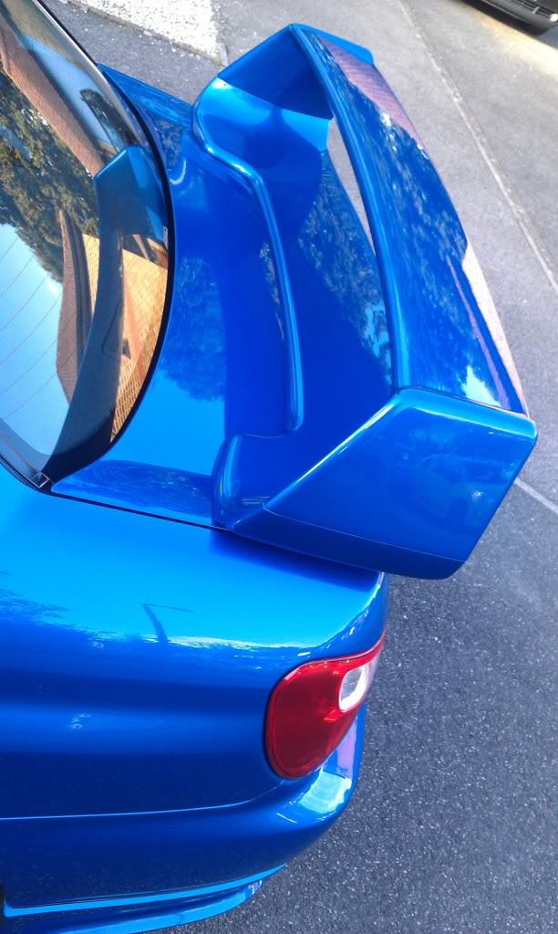

Huge thanks to Ron, spent today over at his place tidying up a few bits on the scoob, he certainly knows his stuff when it comes to detailing.
Got the new paintwork on the spoiler/bootlid mopped so that the finish matches the rest of the car better (rest was of the car was machined in April i think). Nice coat of wax on the whole car too and she's looking very shiny

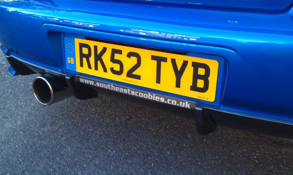

Also gained another sticker, Ron found a few leftover from a couple of years back when we had a load made up! Nice and subtle and sits perfectly under the number plate.
  #104
Old 13-09-2012, 06:33 PM
Should get a good 270 or so from that then!
Not sure what it'll make, its still a TD04 so i know its limited at about 285 max. Anywhere 270-280 will be a nice little improvement
  #105
Old 13-09-2012, 06:43 PM
Car`s looking great Steve
  #106
Old 13-09-2012, 06:56 PM
Nice to see the spoiler on mate

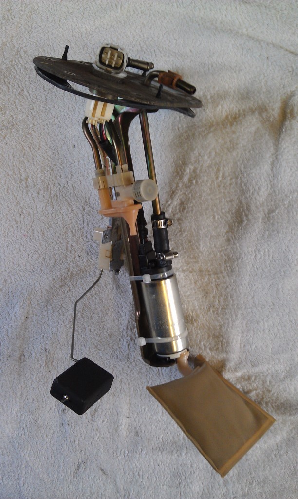

Bit of an update.... ordered some bits from Alyn - walbro 255 and a cam belt kit with all the idlers/tensioner - the car is ten years old now so due its second belt change on age (even though its not by mileage yet). Also stocked up on a few bits like oil, filters (black ones available from RCM) and PFR7B plugs for service which is due soon.
Decided to have a go at the fuel pump swap today, surprisingly straightforward job (thanks to JGM for the brief instructions on his website).
Cover off, used a brush to clean the loose dirt away as didn't want any falling in the tank.
New walbro hooked up, using the old sock as everyone says they're better than the new ones.
Not bad for a couple of hours work (including taking rear seats etc out) - and saved a few quid on having SMD do it for me Just need to get it booked in with them for the service/cam belt change plus downpipe fitting now!

Nice work Steve, saved yourself a few quid in labour! Is it a straight swap with no alterations needed?
  #126
Old 28-10-2012, 03:47 PM
Yes mate, surprisingly easy. The pump came with a new hiring harness with loose ends to join into the car's existing wiring, but the Subaru plug off the old pump fits straight onto the walbro so didn't need it.
Pretty easy job, although i needed a second pair of hands to help hold the frame assembly whilst i used both hands to slide the rubber fuel hose into place onto the pipework.

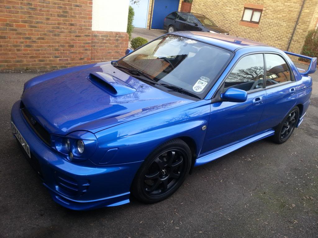

Little update - still haven't got round to getting the decat downpipe fitted, or getting it serviced. Cam belt kit is still in the box too. But then the car only does a couple of thousand miles a year so not the end of the world, just need to make sure its done before Germany.
Spent today giving the scoob a proper clean, I used it for commuting for a week when we had snow so it was pretty filthy. Scott popped over with another set of wheels so they'll be making an appearance as soon as I get the tyres swapped.

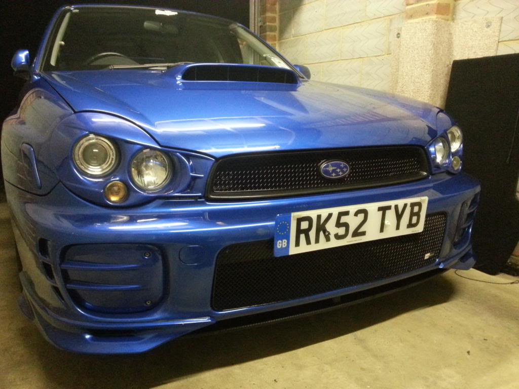

Quick phone pic taken this evening after removing and respraying both Zunsport grilles, they were pretty badly stonechipped beforehand.
  #130
Old 03-02-2013, 07:03 PM
Looks lush Steve, the grills did need a touch up from when I saw them at PP. looks much sharper now with some fresh black.

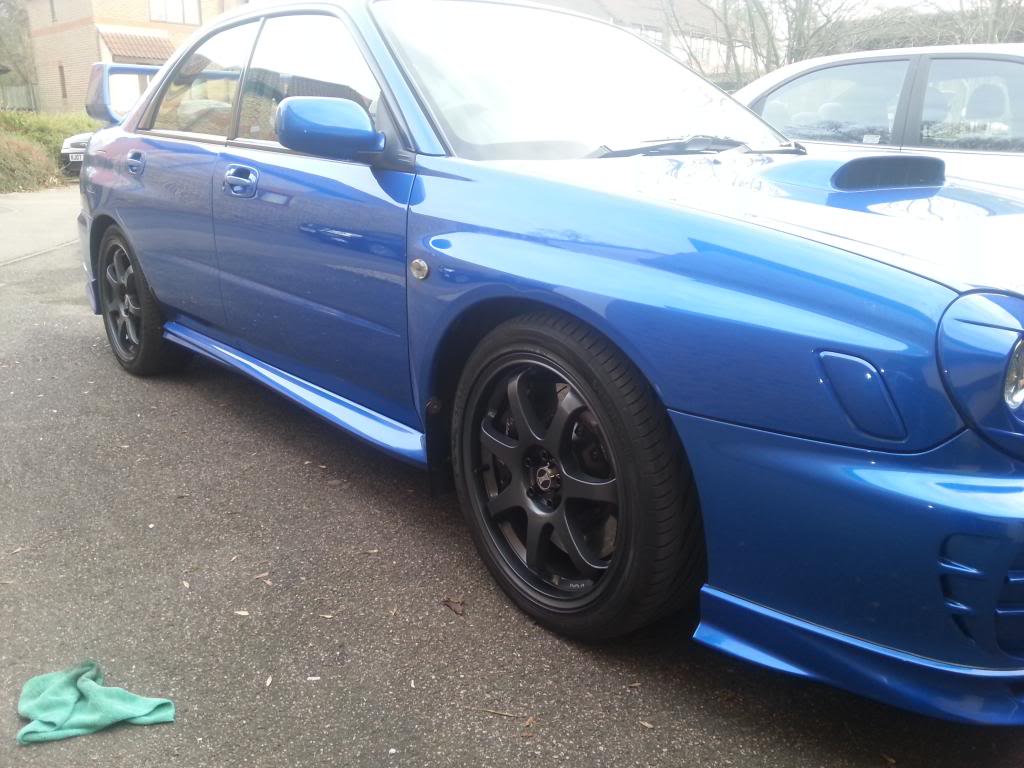

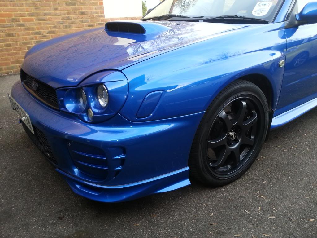

New wheels on today, after getting the tyres swapped over. They're 18" Ultralite Atec's.
They're not as shiny/blingy as my last set, but they're a lot easier to clean! Excuse the camera phone pics...

Awesome, makes it look ten times better and so aggressive looking!!!

Glad you got them sorted, but personally prefer the old ones. Look to small in those pictures! Just my opinion!!!

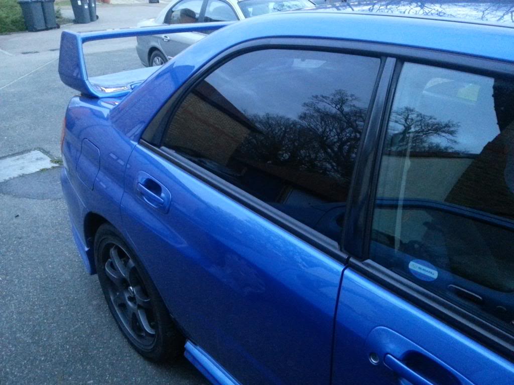

The wheels give the car a nice touch Steve got anything else planned for the car this year
  #139
Old 16-02-2013, 08:23 PM
bonner's Avatar
bonner bonner is offline
Join Date: Nov 2012
Location: East sussex
Posts: 1,288
looking very nice!!! what did you do with the i think torques? love the rear defuser wanting one myself to hide the diff ect did it cost much?
  #140
Old 16-02-2013, 08:26 PM
Agree. I do like dark wheels on a blue scoob looks mean.
  #141
Old 16-02-2013, 08:41 PM
Look good Steve , I see you even managed to get SES on the tyres
  #142
Old 16-02-2013, 11:14 PM
sorry steve,but liked the other wheels better. as long as your happy good enough.
  #143
Old 16-02-2013, 11:31 PM
Yeah, got them sorted today. Thanks for the offer to help out though mate, just haven't really got room to jack the car in the garage and didn't want to leave it out for a few days on stands either.
They do look smaller, but i think thats because they have a quite a deep lip on them which is almost the same colour as the tyre. I like the 7-spoke style though and its a change having had the others on there for 3 or 4 years
Thanks, decat and remap planned (if i ever get round to it) and just service items/cam belt to get the car ready for Germany again.
The torques are currently in my lounge (wife is unimpressed ) and will be for sale on here as soon as i've taken some pictures. The diffuser comes as a kit with the rear side spats, seem to be rocking horse poo as i've not seen another set come up for sale since i bought it....
No worries mate, there's no denying i loved the old wheels too. Just fancied a change!
  #144
Old 17-02-2013, 08:26 AM
bonner's Avatar
Join Date: Nov 2012
Posts: 1,288
lounge lol im just as bad the defuser makes a world of differnce!! very nice mate!
  #145
Old 18-02-2013, 10:46 AM
WOW!!! Its incredible how different the car looks with those wheels. Liked it well enough before but I think those are absolutely spot on. Somehow they look bigger to me.
  #146
Old 26-03-2013, 08:13 PM

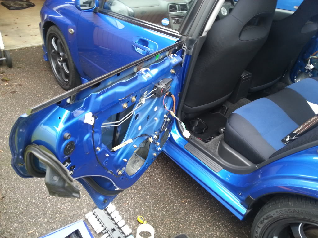

Another little update.....
Car was down at SMD last week for an oil service and spark plug change, fit the cam belt kit i'd bought from Alyn last year (+ water pump) and fit the decat downpipe. Car was given a good checkover and everything as it should be
Also managed to swap the rear door glass as it was scratched as some of you know by a certain dent repair company several years ago. Removed the glass myself and swapped it with MSR2012's glass from his JDM bug that he's recent broken. Its already tinted so that saves me a job. Also had the set of STI doorcards off him, as the set that came with my STI7 seats were marked and i never fitted them as wasn't happy with them. These ones are pretty good though
Also removed the rear speakers as they don't do much and its a little weight saving lol
Bit drafty for this time of year....
New glass in
And new door cards

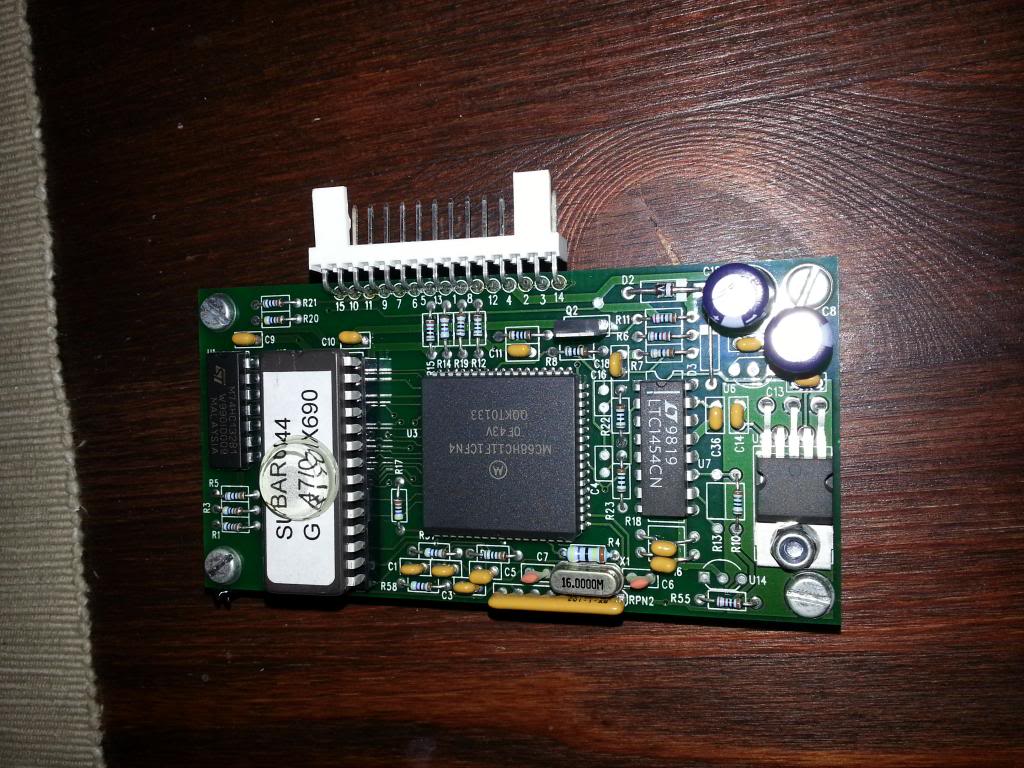

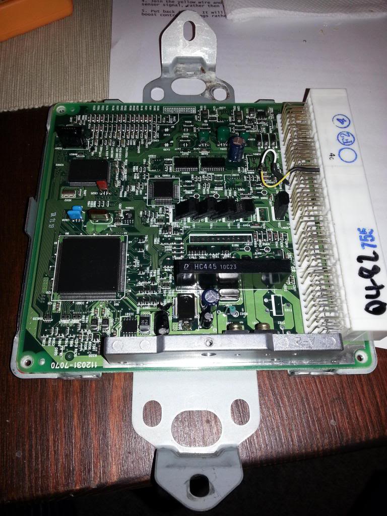

The car has had the PPP since pretty much new but as its a bugeye the ECU had an additional circuit board added inside to raise the boost. After speaking to Scott, i know now this needs to be removed for a remap so that the ECU handles the boost control again.
So ECU out of car and PPP board removed.
The PPP board looks like this:
All now back in the car and relieved that my soldering (in)ability didn't fook anything up, car still works
It would be interesting to know what these boards are fully capable of as they are made by GEMS and have a lot more functionality then the PPP used.
It only connected power and the map sensor. It has a lot more pins on the edge connector that are not used in PPP guise.
