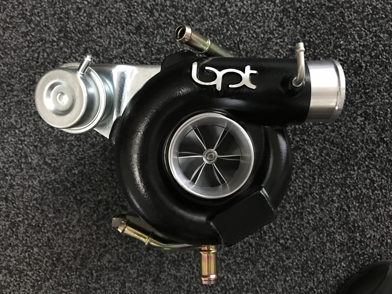

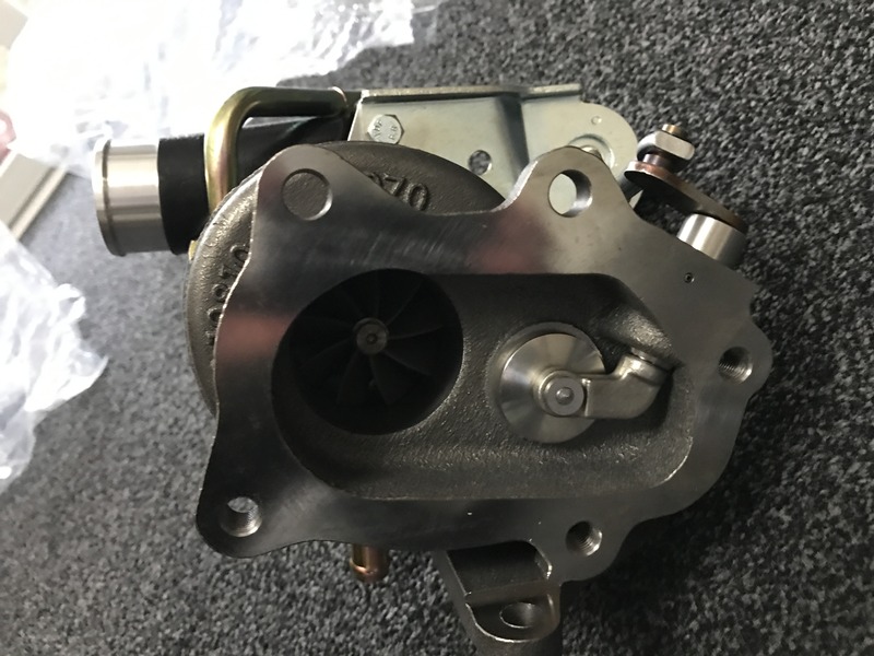

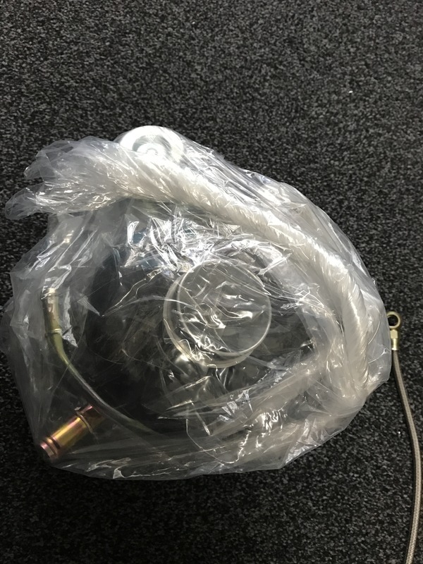

Yeah the measurements didn't match up - so new turbo being dispatched today to me... geo is all done, and yes it will be good to get it out on the road! And Lydden!
I am having trouble sourcing a quieter back box on a 3" though. I don't want to replace centre section and back box, as it would only be swapped out on track days.
Closest I can get is a Hayward and Scott back box that reduces dB by around 4dB.. which isn't enough...

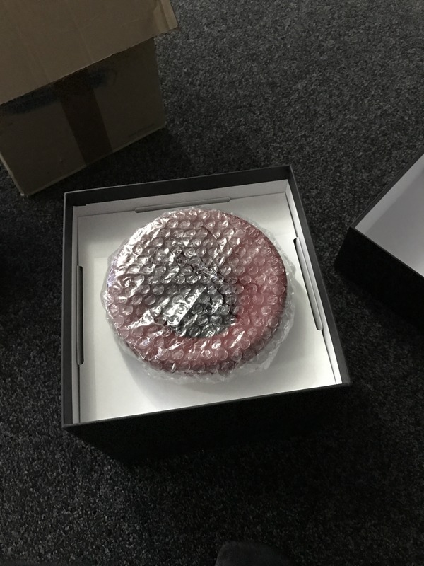

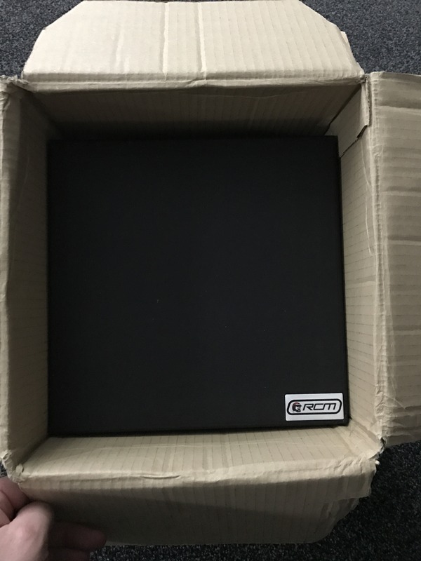

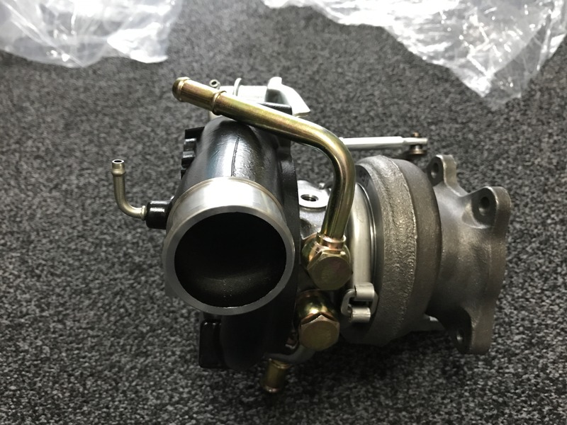

Old 01-08-2017, 06:10 PM
Well small parcel arrived today....
That along with the replacement proper SC38 that is arriving tomorrow should hopefully see me to where the car should have been 2 months ago...

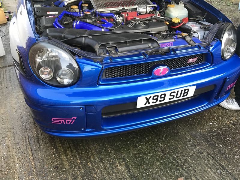

Old 05-08-2017, 05:03 PM
Ok so small update.
RCM baffled sump - Installed
Cosworth timing belt kit - installed
RCM 11mm Oil pump - installed
New water pump - installed
Oil & filter - changed
Oil Modine Seal - Replaced
Coolant - changed
Fuel filter - changed
Class 7 plugs - changed
Rear hardrace arms - installed
Geo setup - done
340ltr fuel pump and RCM 850cc injectors - purchased
290ltr pump - going to good home
Map tweak + Anti-lag + Launch control - booked
Pact made that if I don't get 374bhp or more then next years 2.1, MD321v, front mount will be the way forward!!!

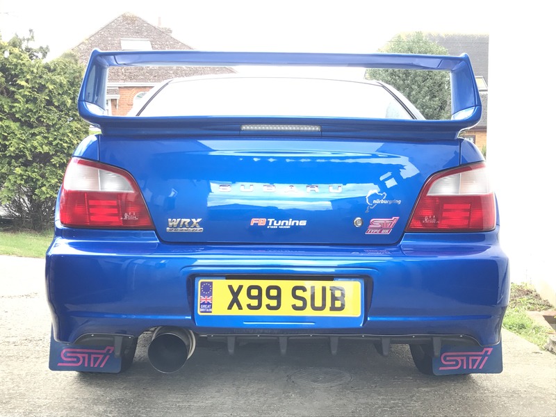

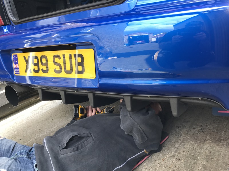

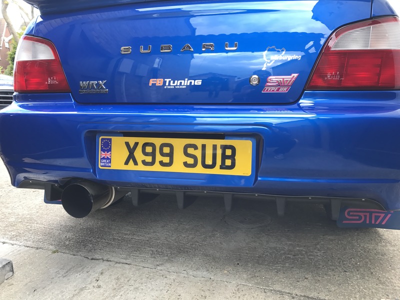

Old 22-10-2017, 12:06 PM
Default The Bug...
Well back from Kevin at Zero Exhausts... brilliant guy who knows his stuff!
The car now has a modest 3” tailpipe, and 385mm long 250mm wide baffle in the back section. Still with 3” fitment for easy swapping out on track days.
Gotta say on the drive home, It’s was positively silent!!! At start up there is a little burble, but as soon as you put revs through it, nothing! I would even go as far as to say it’s a nice quiet ride now. Well beside the huge induction and turbo noise I can now hear as I am not be droned out by the exhaust
Quality of the welding and workmanship looks spot on!
  #538
Old 22-10-2017, 05:55 PM
Very nice mate. Underside of your bug looks a lot cleaner than mine!
  #539
Old 22-10-2017, 06:04 PM
Thanks Steve
Although that’s only because you can’t see my rotting u-cradle..
Is nicely made though..

Quiet, whats that , looks a quality bit of kit
  #541
Old 22-10-2017, 08:51 PM
Good stuff, only heard good things about this guy's work.
  #542
Old 23-10-2017, 09:43 AM
Thats some quality of work looks nice too .
  #543
Old 23-10-2017, 10:16 AM
Nice, need to have a listen!
I reckon that's got to sort you for those 95db trackdays!

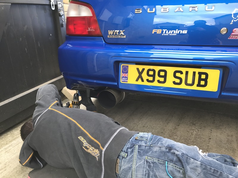

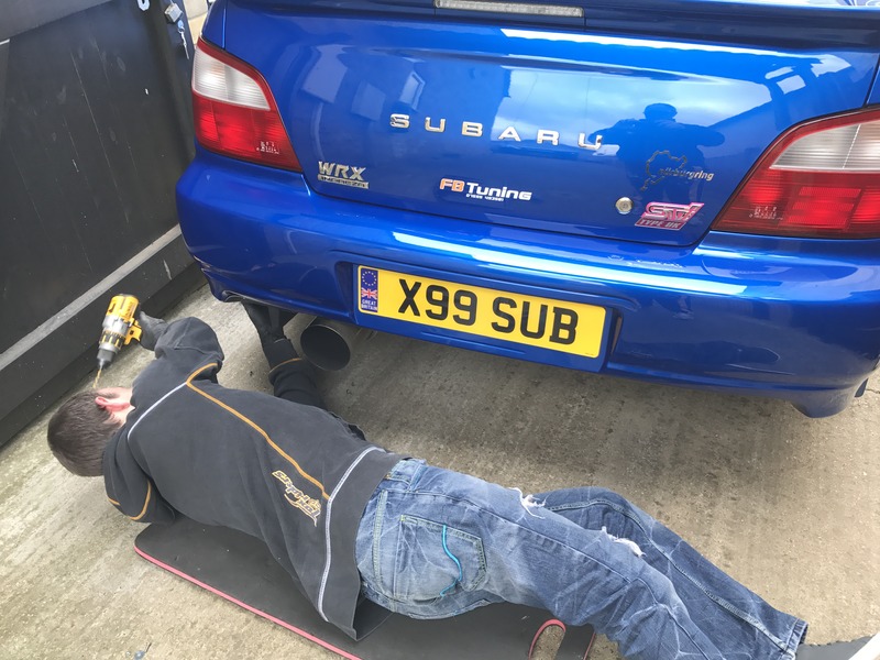

Well I did give her a start up when the old back box came off and before the new one came on - it sounded like a meths mad machine pmsl!
  #555
Old 22-01-2018, 01:56 PM
I did that last time I changed mine
  #556
Old 22-01-2018, 03:33 PM
Me too, its the law

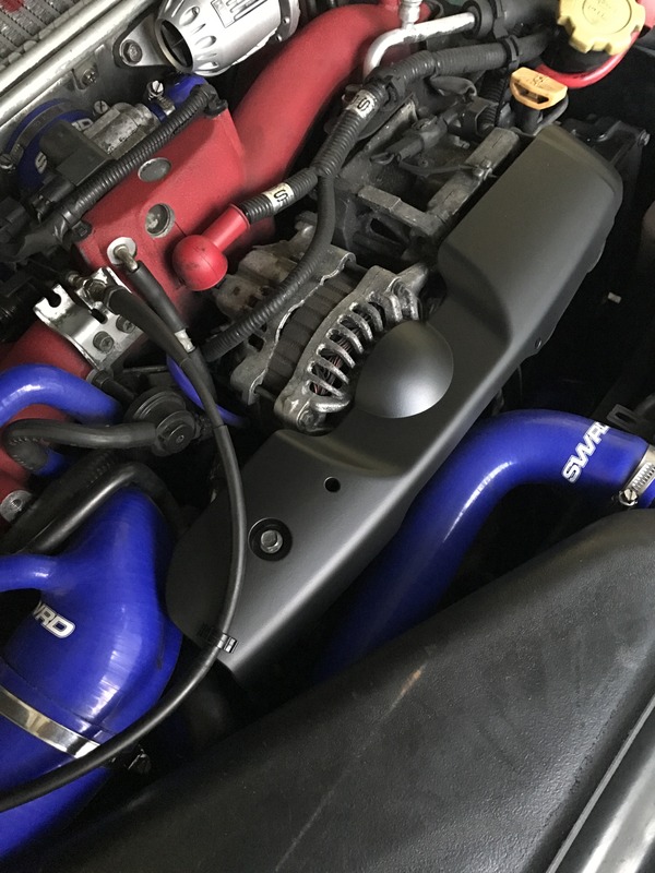

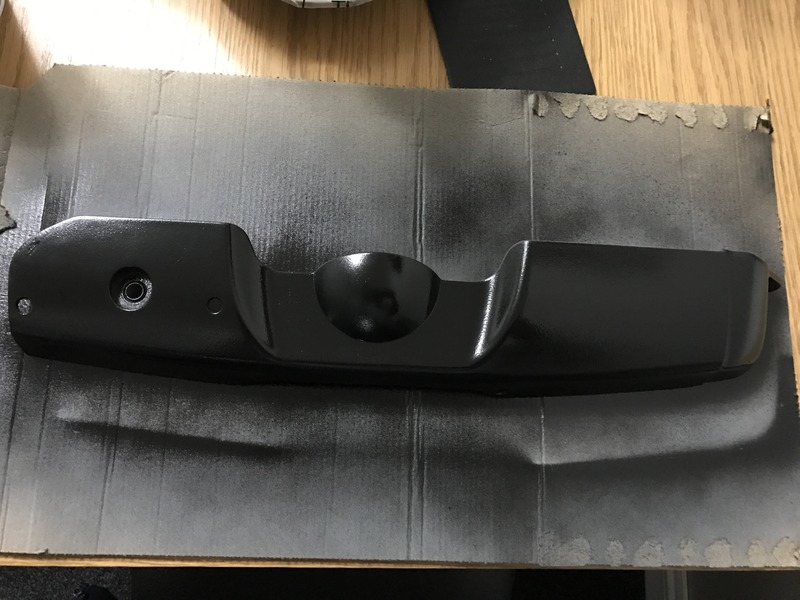

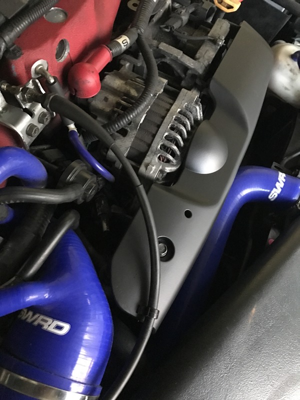

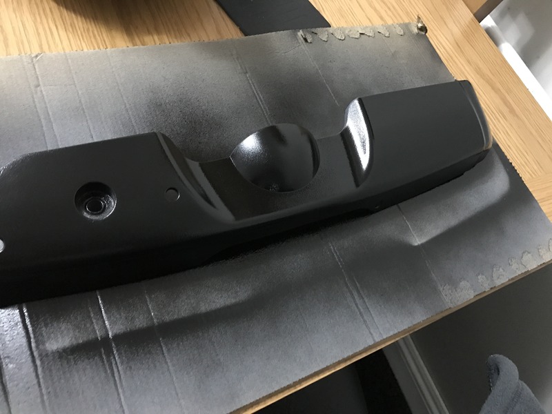

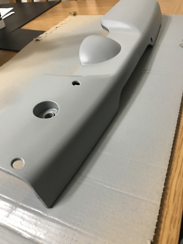

Was bored today and weather wasn’t bad so decided to smarten up my flaky blue air divert panel...
Nothing major but now a tidy matt Black.
  #570
Old 10-06-2018, 08:52 PM
Looks tidy, it's the little things that make a difference

Needless to say I gave the rest of the engine bay and the snorkel a good clean also... just couldn’t be bothered to pic it

One day later I was the proud owner of an RCM Track Track Catch Can Kit with return to my RCM baffled sump and had Tom, Mick, and Rob install it before I collected the car today.
